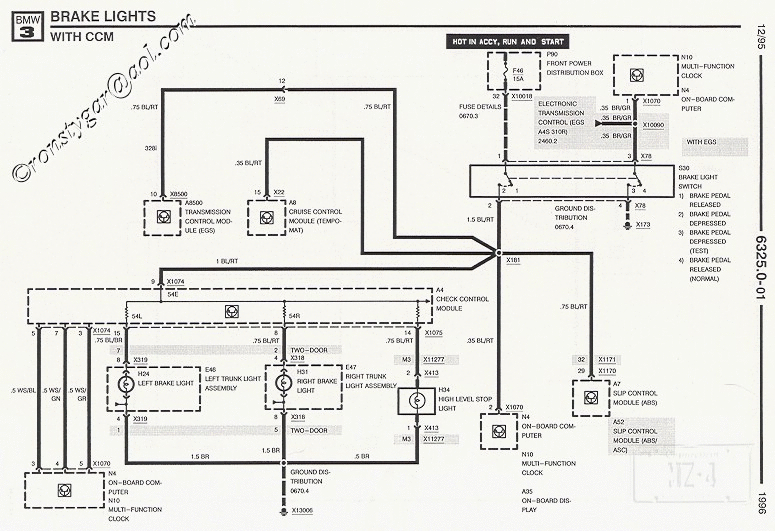

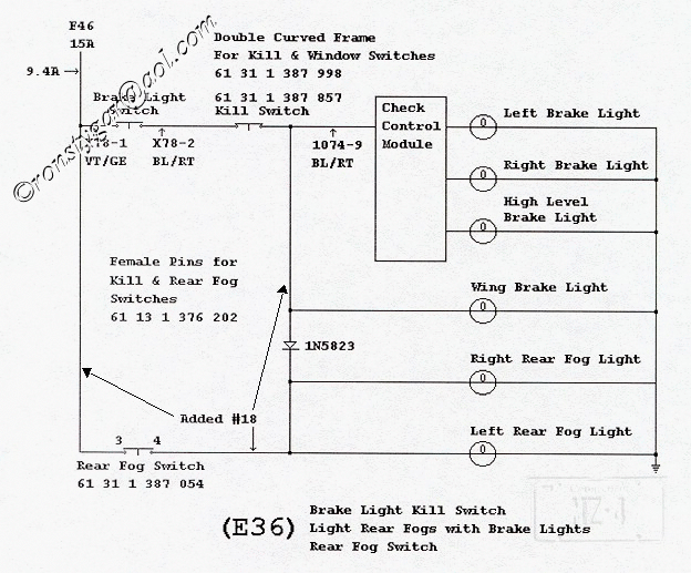

    I got a response from Ron Stygar. The schematic is at:
    http://www.unofficialbmw.com/images/...schematic1.gif
    http://www.unofficialbmw.com/images/...schematic2.gif
    I found some pretty stock looking switches for the knockout panels ahead of the shifter. I'm currently using a black one for my radar detector. They also come in lighted blue or red. I'm probably going to wire a lighted red toggle switch through a relay so that the switch lights up when my brake kill is ON just as a warning and reminder to me.
    I also plan to place the relay close to the brake circuit switch and wire with 14ga wires to minimize resistance (hopefully no OBC error). Hope it works.
